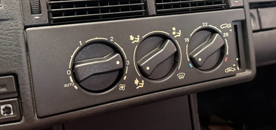

Meanwhile, we found this problem while troubleshooting the AC system. A bad compressor is part of the problem, but probably not all of it. We suspect the control unit may be flaky, wanted to pull this panel out to look for anything disintegrating on the circuit board:
Any advice on how this comes out? I don't want to pull to hard...

The heating/ventilation control unit comes out after the knobs are pulled off. Use flat pliers to gain a good grip and pull swiftly. The panel front has screws.
If you want to stop the A/c compressor, use the "A/c Stop" button. The Led being on stops the compressor.

Your car doesn't have Hydractive, so will be more prone to pitch and bob and roll when accelerating, braking and cornering, than one with.
As your car has rotary heater controls the airflow direction is cable operated. Check the cable is actually connected, the outer sheath is clipped securely and the flaps inside the heater box can move freely.
The A/c issue is most likely the switch is sticky, a strip and clean may sort it.

It definitely feels like the cable isn't actually connected as the rotary spins so loosely I didn't even know it was cable operated!
