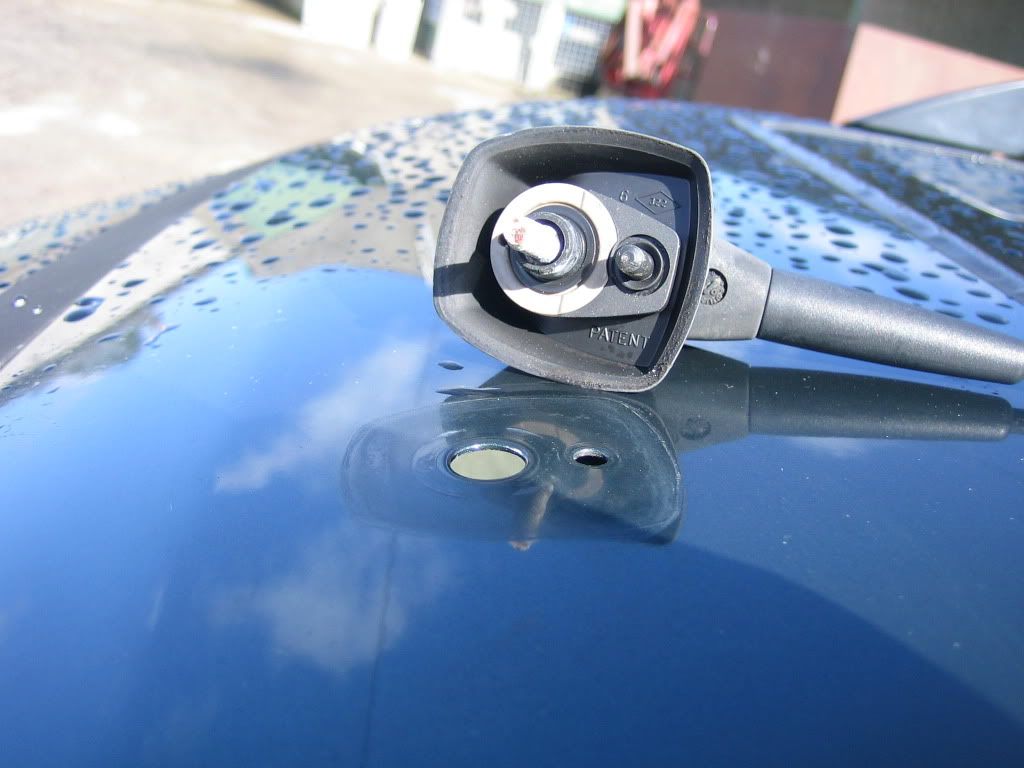

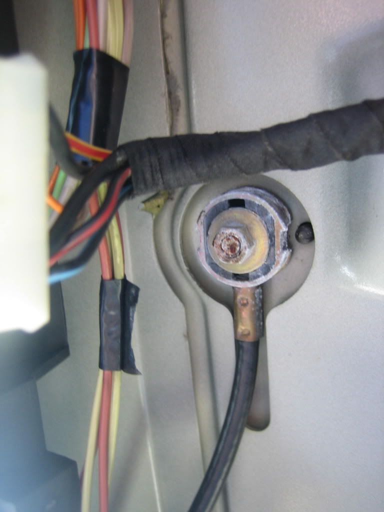

Here are a couple of pictures to show you how to remove the aerial and what to expect. There is a metal cap over the bottom of the aerial base covering the nut, pull it off with pliers. The nut is 8mm.
