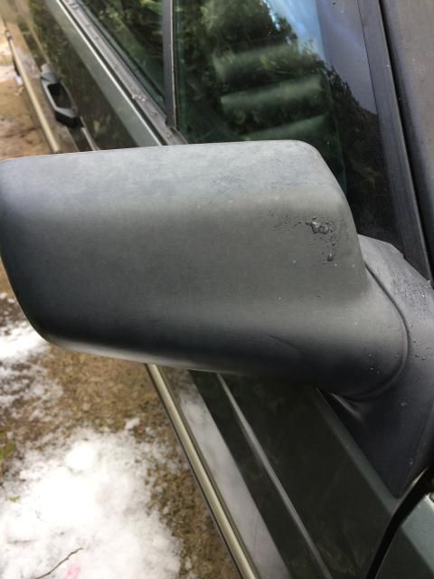

Pre anything

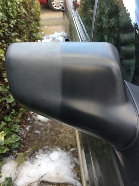

After a single wipe down with some autosol gently rubbed in

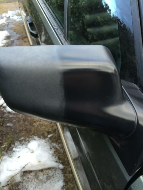

With a final application of Meguiars trim restorer
